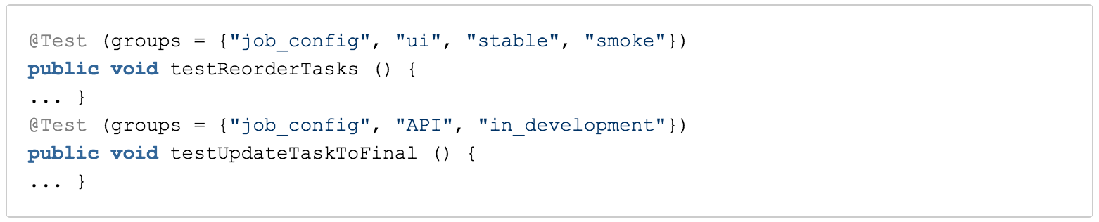

Parallel test groups
Each test has been assigned to groups representing functional areas of the application, level of technology stack, maturity level, and whether it should be run as a post-deploy smoke test. This is incredibly powerful because you can use these assignments at run time to pull tests from disparate classes or packages and run them inside a single job. A job that runs all the API-level tests having to do with configuration functionality, for example. Or a job that runs all the tests for features that are still in development and not really expected to pass yet (TDD, anyone??).

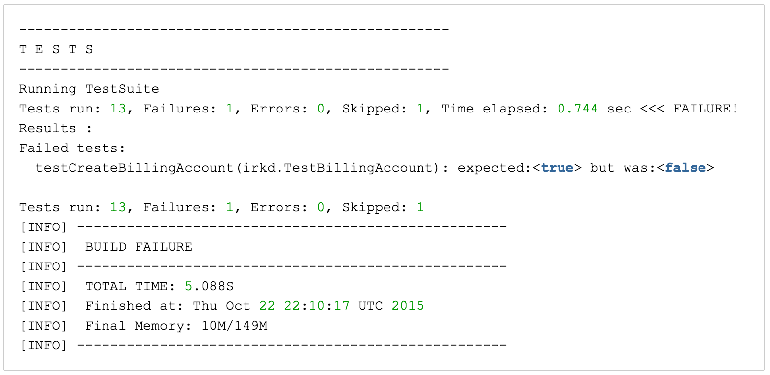

With TestNG, the default behavior is to simply skip a test if its upstream dependency fails. We love this for two reasons. First, executing the actual test is a waste of time and just means you wait that much longer to find out this revision of your code no es bueno. Second, when you look at your test results, your count of skipped tests makes it immediately clear that something fundamental to your application is borked. Much faster than diving into 350 test failures and, somewhere around number 20, noticing that they’ve all failed on exactly the same call.
And it’s not just set-up methods that can trigger a skip. If you’ve declared TestA as being dependent upon TestB, and TestA fails, TestB will be skipped. Here’s what that looks like in your build logs:

Like a handful of other testing frameworks, TestNG takes its cues from an @Test annotation. Inside that, you can place a number of attributes, one of which is Groups. Group names are both dynamic and arbitrary –that's a small sentence, with big implications.
First, you can create a new group on the fly just by assigning a test to it. No need to declare and define the group in a separate file. The act of assigning a test to a group will also create that group, if it doesn’t already exist. (Now, that’s a double-edged sword because it also means you can end up with a group called “smoke_test” and another called “smoke_tets” if you’re careless.)
Second, you can devise whatever system (or systems) of meaning you like for your groups. Slice them along functional area of the application, by level of the code stack, by whether you currently expect the test to pass, etc. And tests can belong to multiple groups. So a single test might conceivably belong to the “user_authentication”, “API”, “smoke_test” and “in_development” groups. TestNG even supports groups of groups! Look at their documentation to find out more.

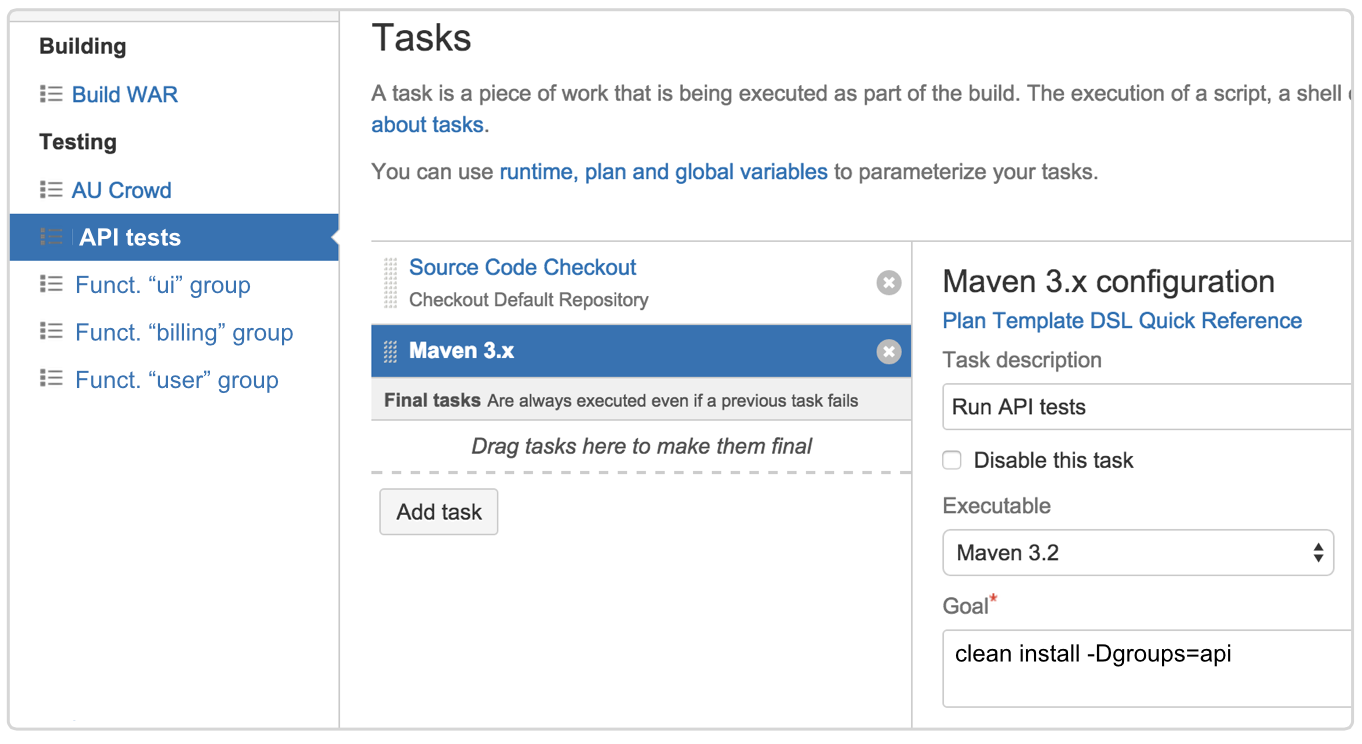

Bamboo allows setting up jobs based on the groups you’ve defined in your test code. If you’re executing tests via Maven, Gradle, or Ant, this is pretty trivial. In the example shown here, we are passing a group name into Maven as an argument. When it’s time to run the tests, TestNG will scour our project, pull out all the tests belonging to that group, and run only those. It doesn’t matter if the tests for that group are located in different classes or packages. As long as they’re in the same project or module, TestNG will find them.
Continuous integration is all about quick feedback, and of course the number of tests you run has a huge impact on the feedback process and speed of your integration pipeline. It does not take the same amount of time to run 10 tests as it takes for 10,000. With Bamboo's parallel jobs feature, and TestNG allowing us to split tests into batches we can save lots of the test execution time compared to if we have to run things in sequence.
Parallel testing jobs screenshot
Note that because each job has its own working build directory, you’ll need to add a Source Code Checkout task at the beginning of each job to pull down the test code. If your code base is large, you can take advantage of the option to check out from a sub-directory in your repo and only pull down that part of the tree.

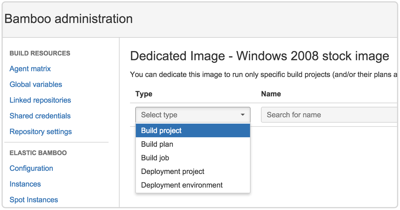

When thinking about agents, don't forget about our latest agent's feature: dedicated agents. This feature allows assigning an agent to a certain build or deployment so it doesn't have to sit in the build queue.
