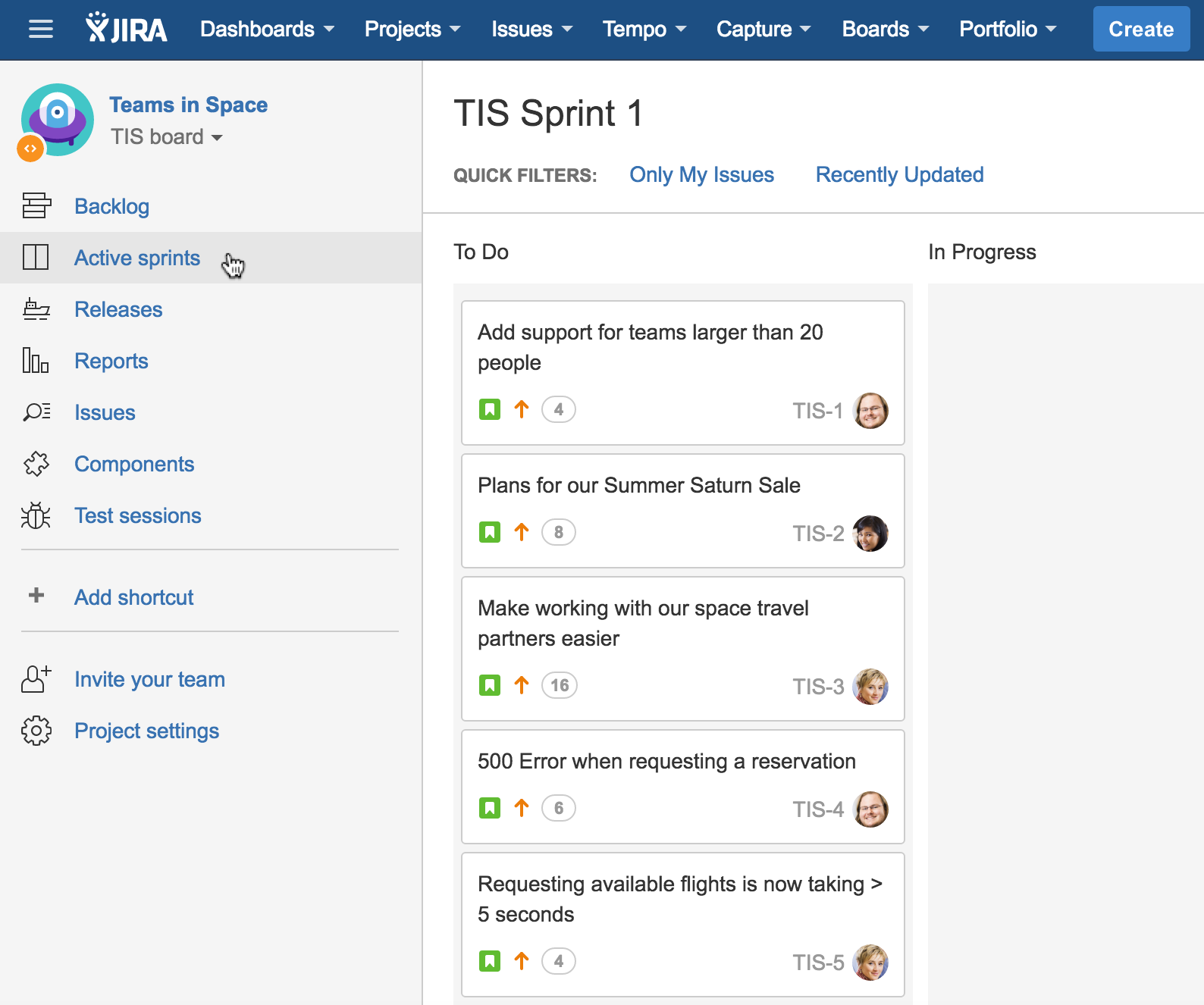

Step 7: Start your first sprint
Name the sprint. Some teams name the sprint based on their goal. If there is a commonality between the issues in the sprint, name the sprint around that theme. Otherwise, you can name the sprint whatever you like. Add a duration of the sprint and start and end dates. The start and end dates should align to your team's schedule. For example, some teams start sprints on a Monday and then end on a Friday morning in the next week. Other teams decide to start and end their sprints mid-week. It's up to you! If you're unsure how long your sprints should be, we recommend trying two weeks.
Once you start your sprint, you will be taken to the Active sprints tab in the project.
Active sprints
This is where your team will work to pick up items from the to-do column and move them into in-progress and eventually, done!
